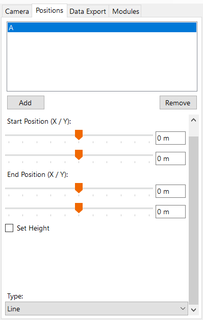

Positions
The term “positions” refers to lines or points on which firework effects are placed in the simulation and in the reality.
It is not necessary to use positions at all - you can also place your mortars anywhere in space. However, if you do that, you will not be able to use the Data Export features.
Creating positions and aligning effects
In the sidebar, select “Positions”. There, you can add, remove or modify positions.
At the same time, your positions (points or lines) will be shown in the 3D world:
You can now move these positions in the 3D view, or enter the exact positions in the sidebar fields.
If you move effects in the 3D world, they will automatically snap onto positions. If you do not want your effects to snap, hold the CTRL key while you move them.
