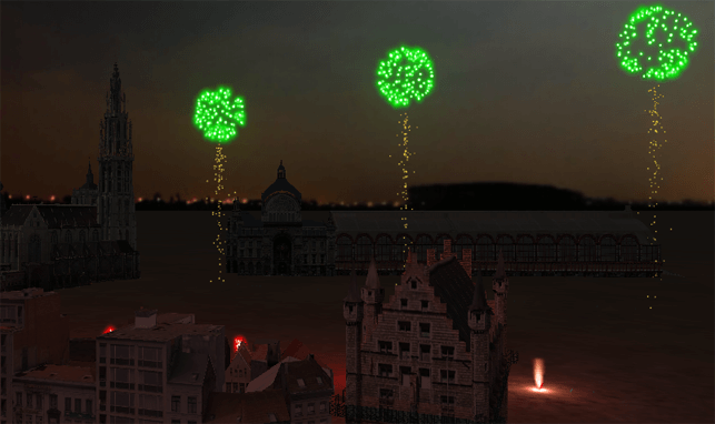

If you use the Sketchup 3D modelling software to create your models, you might want to integrate them with fireworks. In order to do that, you can use FWsim.
Please follow these steps:

Fireworks combined with 3D models
