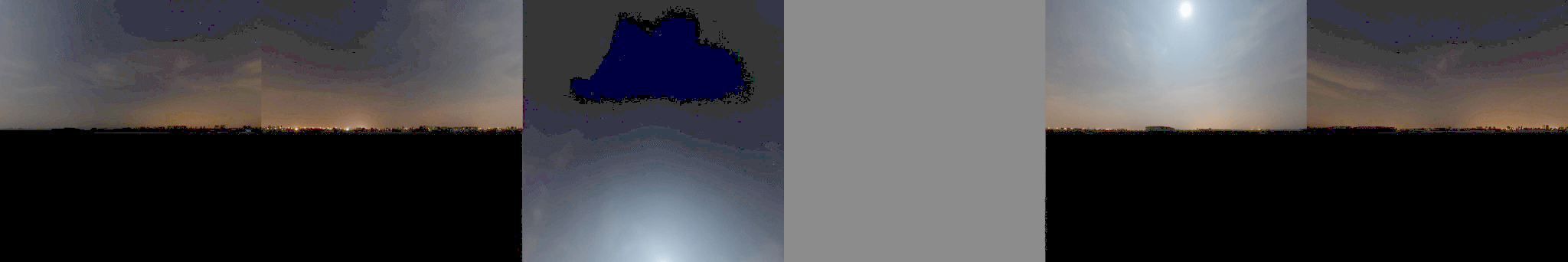

FWsim uses 3D backgrounds called Skyboxes. A skybox is a cube. The entire 3D world in FWsim is placed inside this cube. The six sides of the cube are painted with images, to make it look like one continuous 3D environment.
This is the default skybox in FWsim. Click to enlarge.
By replacing the file skybox1.png, you can use your own 3D backgrounds in FWsim. This file contains the six sides of the cube strung together.
It is beyond this article to explain how to create Skyboxes; however one can readily find articles on the internet explaining the process.
Keep in mind that the alignment of skybox images that FWsim requires might be different from the format that other software packages use. So you might need to use image editing software to change the order of the images for the skybox1.png.
